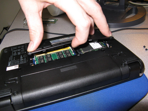

Start by turning the Mini over and removing the two screws indicated by the red circles.
Use your finger to gently pry the module cover up at this area and pop it out
and remove it

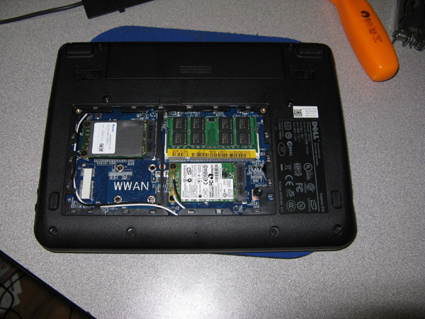

Gently pull the two metal tabs indicated by the circles to the sides, away from the center of the memory chip.
The chip will pop up to about a 25░ angle and you can remove it.

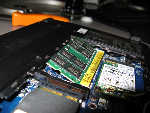

Insert the new chip into the socket, making sure it is fully seated. Note that you cannot see the gold contacts at the bottom of the chip when it is fully inserted in the socket.
Gently press down on the chip until the two metal tabs you moved before lock into place on the new chip. This does not take much effort at all (one finger) so if there is any resistance, make sure you have the chip seated properly.
