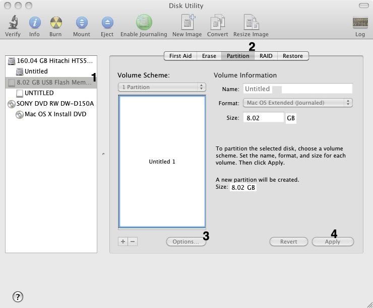

Open Disk Utility.
Select your flash-drive. Select the partition tab. From the Volume Scheme drop-down menu, select 1 partition. Click on options. Select Master Boot Record, click ok. Click apply. This will make your flash-drive bootable.

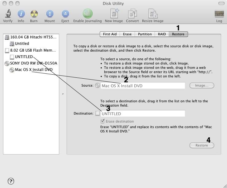

When partitioning completes, Select the restore tab.
Drag the OS X Install DVD icon to the source field. Drag your flash-drive to the destination field. Click restore. On the warning dialog, click erase. This will write the installation files to the flash-drive. It may take a while, so be patient; take a break. When this process completes, your flash drive will have been renamed to "Mac OS X Install DVD." Quit Disk Utility when done.

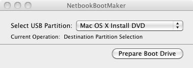

Open NetbookMaker.
It will automatically detect your flash drive. Make sure that Mac OS Install X DVD is selected, and click Prepare Boot Drive. This will copy some necessary files to your USB. They will be hidden, so don't look for them.
Quit NetbookMaker when it completes bootdrive preparation.
