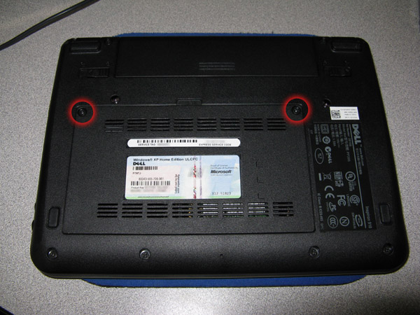

Start by turning the Mini over and removing the two screws indicated by the red circles. You will also need to remove your battery.

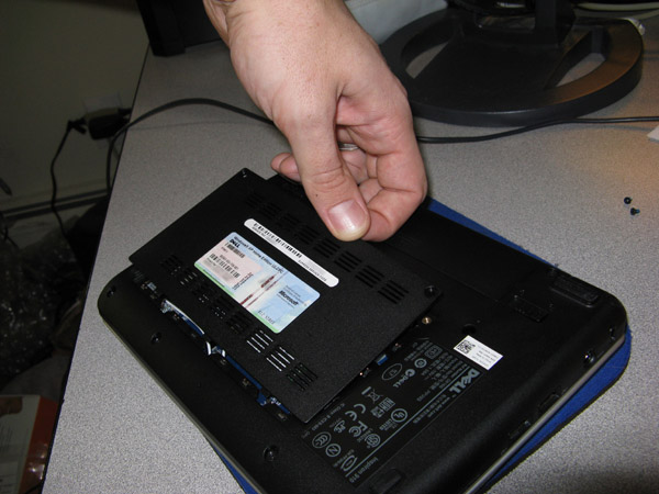

Use your finger to gently pry the module cover up at this area and pop it out
and remove it
