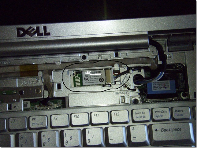

Just so you know the 355 and 360 Will NOT work for the mini. The 360 and 355 are the bluetooth that goes in systems such as XPS machines and Lats as well a vostros. The module its self is to big to fit in the system not only that the dell mini bluetooth has a cable attached the the module and the others do not. And the cable will not connect to the mini. Trust me I know.
THIS PICTURE IS THE 355/360
THis is the mini bluetooth
So if you really ordered the 355/360 you got the wrong part. And you are correct tech support can not order you parts. I am dell tech support. But sales can look up part numbers. As i posted before Dell sales people are dumb, If you do not get the part number from a agent ask to change agents.
